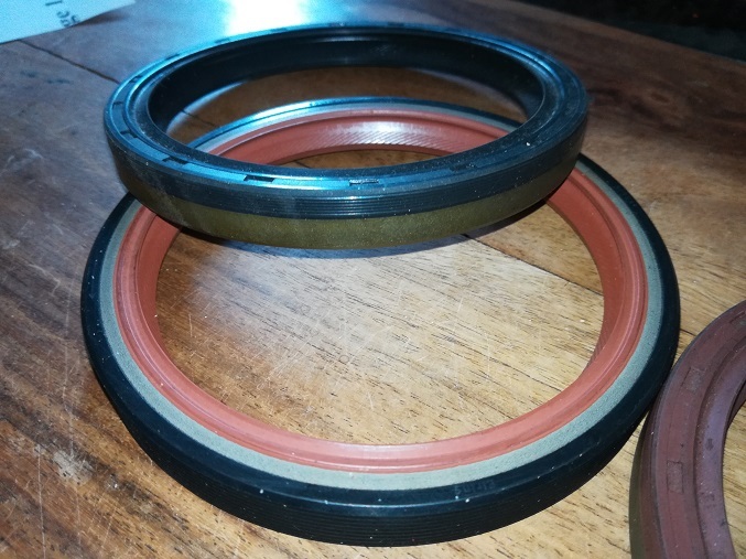

| proporsche | le 05/05/2025 à 14:14 Francois...I have old original Elring seals. I also modify the spring if I buy new ones. I would never use Victor R. seals.… The seal should look like this. ![]() Here's how to repair the spring.. Message edited on 05/05/2025 Message édité le 05/05/2025 |
| François77 | le 05/05/2025 à 16:08 ahhhh, la caméra ;) Merci Ivan, le coup du ressort, un classique ;) |
