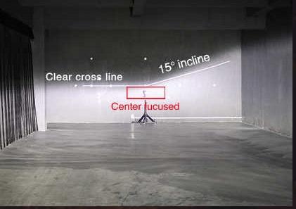

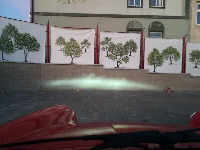

yes of course, the patern H4 loght is made for Europe so the side steps are cover and the driver can see the pedestrian.The patern H5 is the American model and it's like a mushroom patern light if you look on the Wall
low beam H5
low beam H4
